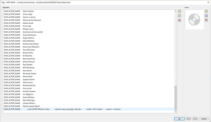

This was able to read ALL the actors into separate temporary-actor fields, but it is only 95% there because some excess data was "left behind". After reading the last "actor" .. it would retain the remaining XML data of the last actor.
I would like help to figure out how to remove that tailing piece of data from the temporary-actors fields.

I think the easiest way would be a second action of the type "Format value" for PLEX_INFO that looks if there is <role> somewhere in %plex_Info% and then delete that plus anything following it: $regexp($meta_sep(plex_info,\\),(.*)\s*<role>.*,$1)
see with then Converter>Tag-Tag a preview if this works .
Just wanted to let you know that I found the fix for it .. I needed to add \s* to the 3rd line after (.*?)</name> from the above pic. After that, the cleanup line (line 4) took out the "blank" field.
