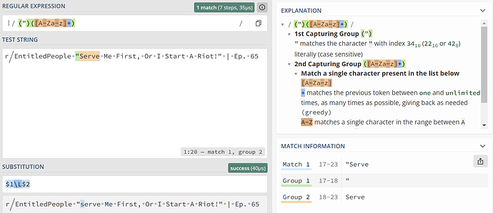

I'm not sure if your regular expression is doing what you want it to do.
It looks that it would search for a quotation mark, followed by a UPPER- or lowercase letter from A-z and if found, write the entire word in lowercase.
Note: The used regular expression checking website does not know the Mp3tag command $lower(). I have replaced it on the website with \L
Your example string
r⧸EntitledPeople “Serve Me First, Or I Start A Riot!” | Ep. 65
will NOT match, because the character “ in front of the word Serve is a
U+201C : LEFT DOUBLE QUOTATION MARK {double turned comma quotation mark}
and not the expected "
U+0022 : QUOTATION MARK {double quote}
used in the regular expression.
Update:
This regular expression would work better:
$regexp(%title%,'(“)([A-Za-z]+)',$1\L$2)
Using the "correct" quotation character is crucial.

The exemple string was copied off the filename of my Opus file. Since I’m on Windows, Double Quotes is a forbidden character. So, the “Left Double Quotation Mark” were used to bypass that. I have a “Replace” function in the “Tag → Filename” function that replace any kind of forbidden filename characters. Before trying to fix this, I ran replace functions all over the 2.5k+ opus files TITLE tags to replace all unicode chars with the ASCII equivalents. Let me double check to make sure what I say is correct… finds and checks file and, yup, copy pasting the character in the tag into this website:
returns
QUOTATION MARK
So, yeah. The example string came from the Opus file I was trying to troubleshoot on.
Wait. No. This very forum changes my straight quotes to “Right Double Quotation Mark”. I just realized this. So, I might have copied and pasted from the tag but the forum changed it to “Right Double Quotation Mark”. I know this because if I copy and paste one of them that’s what I get in the website above. If I do SHIFT+2 (which is my input for QUOTATION MARK - the one used in operations) anywhere else, I get the character I typed and it’s not subtituted automatically. (Side note: I ABSOLUTELY HATE when any kind of software does this automatically for me, thinking that’s what I want. I’m looking at you Macs, iOS and this forum’s software!) (Side-side note: if you do a backspace after typing a quote on this forum software, it’ll change the “ back to ". Just found that out as well.)
