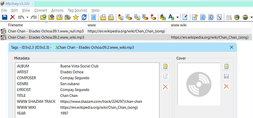

MP3 WWW field (WXXX frame) cannot be exposed in the file list
The %www% field in the file list shows
only WXXX frames whose description is empty.
WXXX frames with a non-empty description are not shown:
We were told that a WXXX frame with a non-empty description
can be shown using %www description% (above: %www wiki%)
(see [You can use %WWW DESCRIPTION%])
Technically this is true — but it is functionally pointless.
The description is arbitrary user-supplied data and is not a part of the tag/field/frame identity.
Users cannot enter %www description% in advance, because they cannot know which descriptions the file’s creator used, and there may be many different ones (see “SHAZAM TRACK” description above). Also there may be many abusive descriptions, like “1”, “2”, “3”, etc, given to URLs to workaround “single-valued WWW” ID3 v2.3, v2.4 restriction.
%www% should expose all WXXX frames, regardless of their descriptions.
Mp3tag version tested: v3.32c, Nov 19 2025 12:36:00 (64-bit)

Good for you. I prefer to see the user-supplied URLs of any kind directly in File List.
Setting aside your interpretation of the ID3v2 spec. According to the documentation [Tag Field Mappings] the field %www% maps to WXXX frame, not “WXXX frame with empty description”. Let it be as documented.

As I've explained before, this is how Mp3tag works wrt. to the WWW field for ID3v2. It's a tradeoff I made to support the description part of the field without adding format-specific UI.
I don't plan to change the behaviour and I'm moving this to Bug Reports > No Bugs
