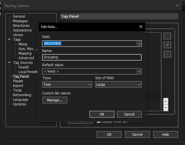

I have had a look at the tag mapping in mp3tag and I confess I don't really understand it at all. Is there a way to get mp3tag to save tags in ALAC files that Audirvana will recognise like it does my FLAC files? At the moment I can either convert the files to FLAC, but then most of the tags go blank in mp3tag and I have to repopulate them, or edit every album in Audirvana using its own very clunky tag editing.

Ok. So if I edit tag panel, and the Grouping tag, in the field selector I can see both CONTENTGROUP and GROUPING, so I picked GROUPING and this works perfectly with FLAC files. If I changed it to CONTENTGROUP would it still be ok in FLAC. And what about CONDUCTOR and STYLE - once again they look perfect in Audirvana and mp3 with FLAC but Audirvana does not see them, and there is no other feild to select in the tag panel editor?

GROUPING has only a standard field for MP3 but not for MP4 - which would lead to a user-defined field in MP4 files.
Style is no standard field - so you would need a player that can cope with user-defined fields.

I have been using ALAC for years as I have multiple Apple devices and was an iTunes user for a long time. The recommendation by @ohrenkino is correct for m4a to use the CONTENTGROUP field. Whether Audirvana uses this field correctly or not is a different question. But that is the "standard" for m4a.
If you want to simplify things, you can create a field Mapping in the options menu. This will make sure any time you edit a m4a file and add the GROUPING tag, mp3tag will store it correctly into the CONTENTGROUP when you Save them.
Type: MP4
Source: GROUPING
Target: CONTENTGROUP
