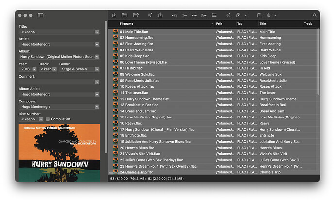

I have a couple of hundred albums ripped to a USB stick for use in the car. I found this problem on my Tesla and also on my Lucid. Multi disc sets wind up jumbled by track and nothing plays in the right order. I have dragged the albums into Mp3tag and everything appears fine but when I go to save them, the track order is jumbled. Is there any fix for this? Thanks.

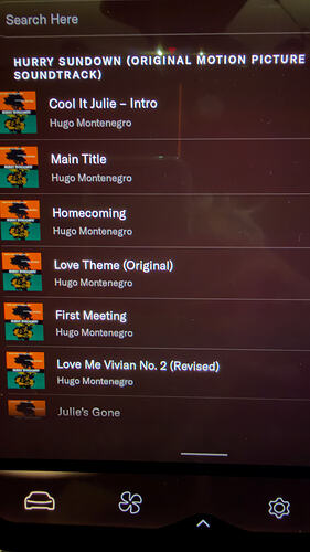

But in the car it gives me 2-01 first, even thought it was remumbered, then main title which is 1-01. It seems to grab tracks from disc 2 and sprinkle them at random in the display, which is here:
It does this on several albums… a 3 disc set is really a mess. I have no idea what method the car is using to decode this.. it’s the same on a Tesl and a Lucid. Hope this helps…
Do you have the same numbers in TRACK as you have in the filename? (The screenshot does not show the track number, unfortunately)

So I think the player has to be tricked - either with an ascending number in the field TRACK - but that could be a combination of DISCNUMBER and TRACK so that
1st track 1st disc gets -> 101
2nd track 1st disc gets ->102
1st track 2nd disc gets -> 201
etc.
Try Convert>Tag-Tag for TRACK
Format string: %discnumber%$num(%track%,2)
If this still does not help, it could be that this combined number has to be added to the field TITLE - but right now it does not look like the player sorts by the title

I assume that you already have data in TRACK and in DISCNUMBER.
The contents of both fields gets merged to TRACK - and MP3tag does that for you for all the selected files in 1 go.
In the function Convert>Tag-Tag you have to set field - and that would be TRACK.
A quick search of Google suggests that the "Album" sorting is based on filenames when using the Tesla media player. So make sure your filenames start with Disc#-Track# then Title is probaly the best option. If you sort your albums into separate Albumartist\Album folders it may help as well.
