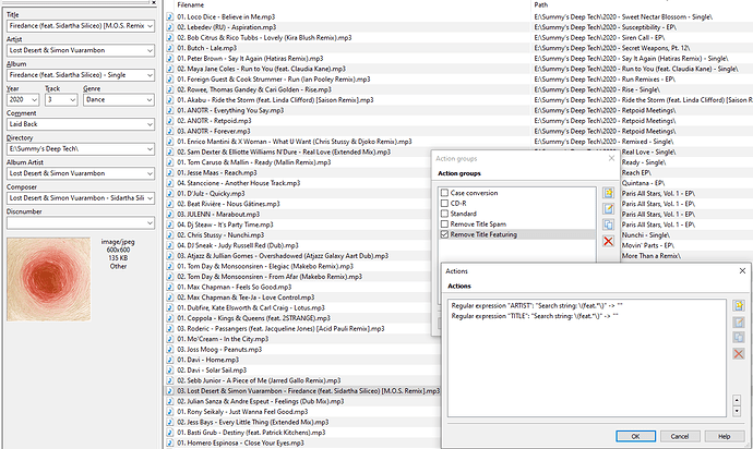

Removing feat. name from the following ARTIST field
Smith & Pledger feat. Carrie Skipper
Using Replace with Regular Expression - Artist - Search string: feat.*
Don't know what should be wrong:
$regexp('Smith & Pledger feat. Carrie Skipper',feat.*,) -> Smith & Pledger
I must be doing something wrong...? It just doesn't work

If the title does not change although the preview shows that everything should be OK, check if the file has APE tags and what the settings are in File>Options>Tags>Mpeg.
Do you happen to read APE tags but you don't write them?
Don't use the words "Search String:" but only the regular expression itself.
This worked THANK YOU!!!
