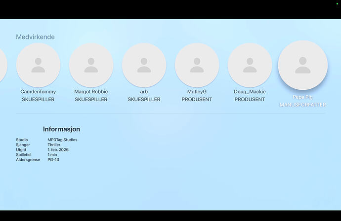

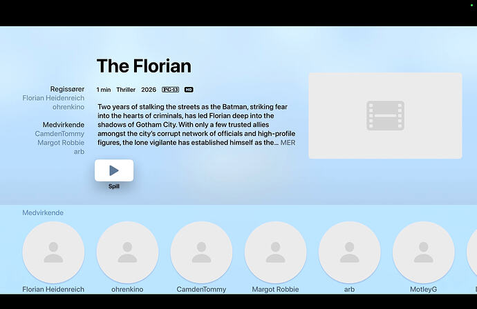

You can check it from an iTunes movie to find out which keys are used. Anyway they are copy-warning studio cast directors codirectors producers screenwriters and also for cast you also have two keys first name for the actor and then actorof for the character.
So eg
<?xml version="1.0" encoding="UTF-8"?>
<!DOCTYPE plist PUBLIC "-//Apple//DTD PLIST 1.0//EN" "http://www.apple.com/DTDs/PropertyList-1.0.dtd">
<plist version="1.0">
    <dict>
        <key>copy-warning</key>
        <string>Do not eat my chicken!</string>
        <key>studio</key>
        <string>MP3Tag Studios</string>
        <key>cast</key>
        <array>
            <dict>
                <key>name</key>
                <string>CamdenTommy</string>
                <key>actorof</key>
                <string>Batman</string>
            </dict>
            <dict>
                <key>name</key>
                <string>Margot Robbie</string>
                <key>actorof</key>
                <string>Batwoman</string>
            </dict>
            <dict>
                <key>name</key>
                <string>arb</string>
                <key>actorof</key>
                <string>Himself</string>
            </dict>
        </array>
        <key>directors</key>
        <array>
            <dict>
                <key>name</key>
                <string>Florian Heidenreich</string>
            </dict>
        </array>
        <key>codirectors</key>
        <array>
            <dict>
                <key>name</key>
                <string>ohrenkino</string>
            </dict>
        </array>
        <key>producers</key>
        <array>
            <dict>
                <key>name</key>
                <string>MotleyG</string>
            </dict>
            <dict>
                <key>name</key>
                <string>Doug_Mackie</string>
            </dict>
        </array>
        <key>screenwriters</key>
        <array>
            <dict>
                <key>name</key>
                <string>Pepa Pig</string>
            </dict>
        </array>
    </dict>
</plist>

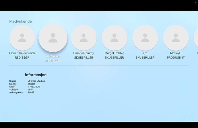

If all this work for Plex, I don't know, but they work on Apple TV.
Oh snap. I had no idea about actorof, clearly not enough research. :sob:
Sadly, I’ve checked and it’s not supported in Plex but I’m noting it down as it will be useful for other things. :drooling_face: Thank you!
copy-warning isn’t supported either, I’m not sure there’s any useful information could go into that aside from a stern warning that no-one will take notice of anyway. Thanks. :poultry_leg::man_running:
I am seeing unfortunately that with scraping from TMDB/IMDB enabled, custom cast/crew gets iffy about where it shows up in Plex apps. It consistently shows a director but again gets flaky about how many directors it shows when there’s multiple values.
codirectors I feel just get treated as an additional director after the “main” one. It’s also unsupported in Plex, how does it show up in Apple TV? As an extra section or just an addition to directors?
(Edit: actorof does show up… as an additional cast member. And is also incredibly picky about where it shows up depending on library type/app/scraping/overview/oh god why can’t this just be standardised.)
It seems to not be used anymore in newer Apple TV and in the TV app, I don't have iTunes anymore so not sure if it still show up there. This is how it is in Apple TV now (this is in Norwegian, but I am sure you can figure that out. Before instead of where it says actor, it showed the character name.
The copyright warning was only visible in iTunes. And directors and co-directors are all called the same, but directors comes before co-directors.
