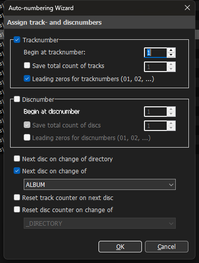

Hi I have some old tracks that do not reset track count on disc change which i've been changing, but I noticed the auto-numbering wizard doesn't have an option for DISCNUMBER. I've seen people talk about it like it should be a field, so is there something I need to enable for it to show up here?

The issue is that since there is no option under "Next disc on change of" for DISC NUMBER, I have to manually select each disc.

Ok but the issue is that there is no DISC NUMBER option for "Next disc on change of"

Is there some sort of setting I have to change to make it show up there? The only options I have are the 3 in my screenshot.

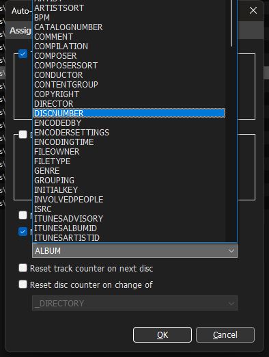

Try this:
  • Open Convert>Tag-Tag
  • Click on the right-arrow-button next to the field list and select "Reset fields ..." from the button menu.
See if this helps.
Late reply but this was it. Thank you!
