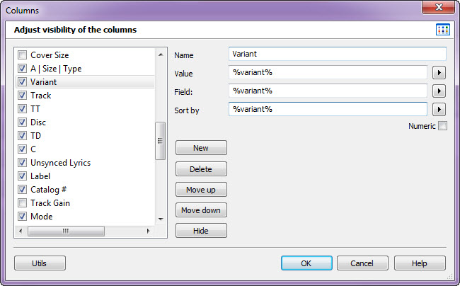

I have made some custom tags/columns named "Lead" (%lead%) and "Variant" (%variant%)
and filled them with some information that show up in columns. But sometimes there is a change
so the info is changed to "ead" and "ariant" instead!? The column names stay right, no change there.
Have I found a bug - or maybe its something I doing wrong?

Yes, it seams when you place two fields in the value part (you can in the fields as long as you don't put anything in the values part) it will behave like this and permanently mess up your tags. My screenshot is a bit misleading. $ifgreater(%_cover_size%,0,%_covers% | $num($fmtnum($div(%_cover_size%,1024)),3) | $regexp(%_cover_mimetype%,'.*/([^/]+)$','$1'),'-') should be in the field section and not the value one. I do not go near this column and click to edit the info so it's okay. So follow my advice at the beginning of this post.

Enter %lead% and %variant% in the fields option of the column setup only and not the values.
dont work for me, I cant edit the cells by clicking them after changing to that. I need to be able to click the cells and edit the content.
THis column displays (! - as there is only a definition in the value) what kind of tags were found in a file and which content you see. I would not remove that column - but it would not hurt either.
If you want to be able to write a FIELD then you have to enter the name of the field.
It is only possible to write to one field at a time. So if you want to write to several fields you either ...
... have to create column defintions for each field separately
... or create actions that copy the contents of one field to another.
A definition for field like "%first% %second%" is invalid. It has to be one for "%first%" and another one for "%second%.

Create a separate column for each:
One example:
Field: %lead%
Value: %lead%

To be perfectly clear setup one column like so for LEAD:
And another for VARIANT:
