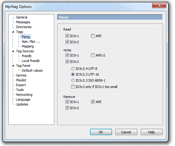

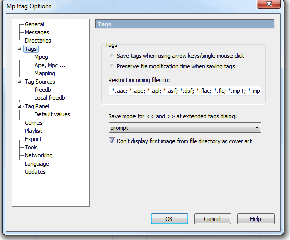

Unfortunately, there is nothing special to discover regarding the involved tagtypes.
You can remove the extra columns.
