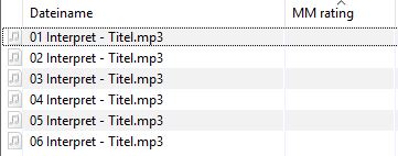

I updated to the MediaMonkey v4.1.23, set ratings new, reload in Mp3tag and also looked up the extended tasks (Alt+T), but %rating mm% is not filled and also gets overwritten after saving in Mp3tag.
