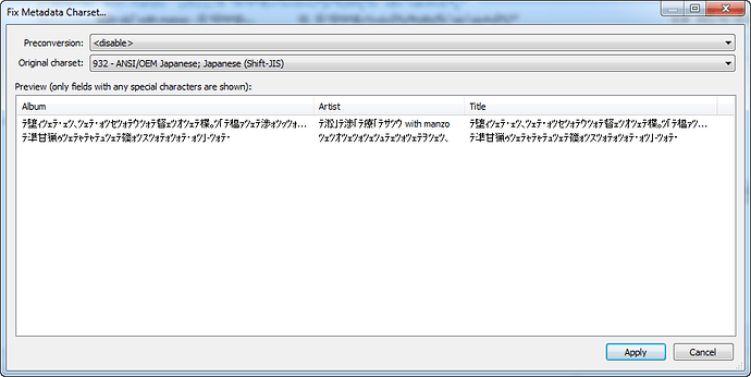

I suggest you try foobar2000 with this plugin:
http://wiki.hydrogenaudio.org/index.php?ti...28foo_chacon%29
Try these settings:
Preconversion:
Original charset: 932
I've tried using foobar with the settings that you recommended however, it still didn't show Japanese. I've fiddled around with it though, it doesn't seem to tag it in Japanese.

Is this correct Japanese?
Try all Preconversion options and leave orig charset to 932
Nope, that's gibberish. Not showing Japanese characters correctly.
I'll try all the Preconversion and see how it goes.
Nope, I've tried every preconversion but none of them shows Japanese...

Use Foobar2000 (32-bit architecture) and use the plugin "Chacon". It is very important to use the 32-bit version of Foobar2000, because that's where the plugin will only work.
1> Import your music in Foobar2000. Their tags should appear as gibberish.
2> Now select all your music files, right click -> tagging -> Fix metadata charset.
3> From here, select the correct coding. Sometimes we need to guess, it is usually one of the non-utf Japanese codings, for example Shift-JIS.
4> Click "Apply"
This should now fix the problem, check them again in mp3tag.
The same method works for other Asian languages and other alphabets like Cyrillic.
