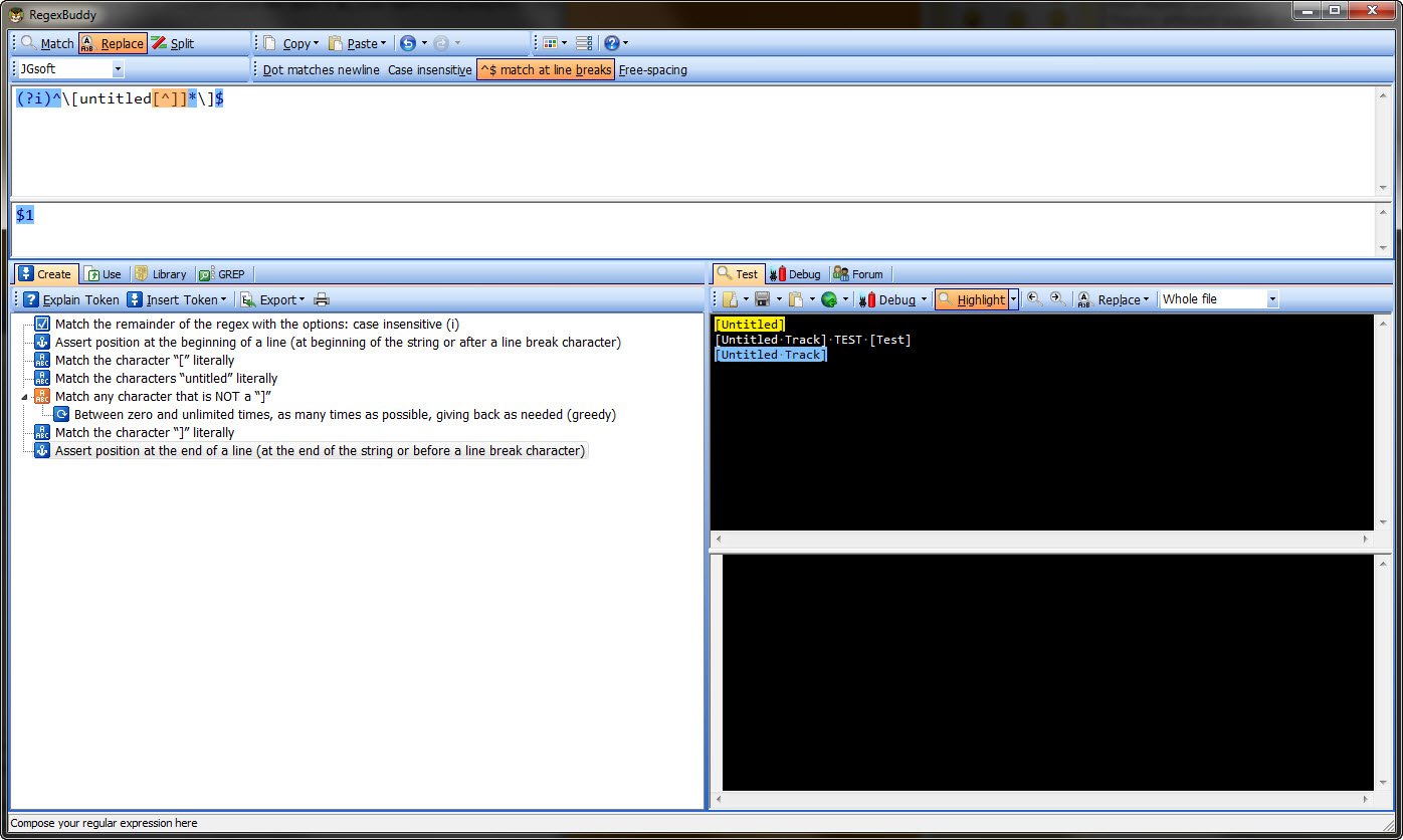

Action #1Actiontype 5: Format valueField ______: TITLEFormatstring: $regexp(%title%,'(?i)^\[untitled[^]]*\]'$,$1 $num(%track%,2))
End Action Group _Script Test#TEST (1 Action)
It searches for the %title% to start with '[' then untitled. It then searches for anything but a ']' between 0 and an unlimited no. of times. Then a ']' This will match both:
[Untitled]
[Untitled Track]
And replace them with your desired format with the %track% formatted with 2 padded numbers.
