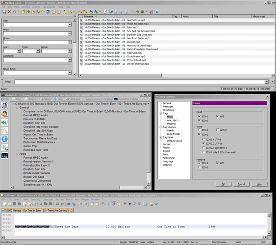

Unfortunately I'm noticing that mp3tag is failing to remove ID3 v1 tags from the end/back of the mp3 files
can i submit this as a feature request?
anyone know what other method i can use to remove these tags? (via hex editor perhaps?)

Have you set Extras>Tools>Mpeg
to read and delete V1 but not to write?
Try then to remove and paste the tags with the functions from the context menu

I have a related question (i believe). I ran MP3val and found no issues. It's entirely possible i have no problem...well no problem with my music files! Anyway what does "id3v2.3 ( id3v1 id3v2.3)" mean? I am assuming (as a search here reveals nothing) that it means that i have multiple versions of my tags tagged to my music. Is this the case? I have mp3tag's mpeg setting set to "read"> all checked, "write"> ID3v2 ID3v2.3 UTF-16 checked, "remove"> ID3v1 APE checked. Again i'm assuming, shouldn't that remove everything but ID3v2.3 and read something like "ID3v2.3" in MP3Tag instead of "id3v2.3 ( id3v1 id3v2.3)" ?
If you have a column that shows you these 2 tag versions then this is probably due to the fact that you have the value defined as this:
%_tag_read%[ (%_tag%)]
The tags work like that APE>V2>V1.
So, if you have V2 tags in a file then only these show (with your settings).
You could run a test and switch off in Tools>Tags reading the V2-tags - you should then see the V1 tags - and their contents could be very different from the V2 tags.
So, if you want to get rid of the V1 tags then you should switch only reading and writing for V2 tags.
Deleting should be enabled for all kind of tags.
If you want to get rid of the V1 tags then cut&paste the tags with the above mentioned settings.
