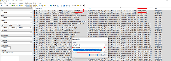

To be able to check this yourself, you could use the convert "Tag -> Filename" ALT + 1.
You will see in the "preview" (green rectangle in the above screenshot) how exactly your final filename would look like.
You can adjust your "Format string" exactly to your needs and then use the action for a mass rename.

The full standard Action I use is to Format Value for _filename using this naming string;
E:\Music\$left(%albumartistsort%,80)\$left(%albumsort%,80)\$ifgreater(%totaldiscs%,1,$left(%discnumber%,1)-,)$num(%track%,2) $left(%titlesort%,80)
This specifies the drive, folders, and filename based off of the metadata tags in each file. As long as those are all updated and accurate, this action can be saved and used to move files to consistent location for every artist and album.

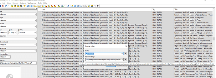

I've probably done it wrong! :face_with_raised_eyebrow: Well I must have because it has not worked!
Apologies for the ongoing errors!
