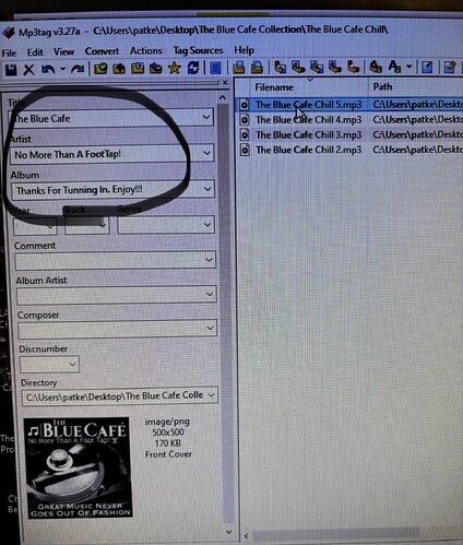

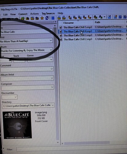

Here's a sample photo...
Looking at the screenshots, I noticed 2 things:
  • The picture format is PNG - which is a valid format according to the MP3 standard but it could be that your player only works with JPG pictures.
  • The field for Album Artist shows no data - adding data to ALBUMARTIST was one of the suggestions to cope with the problem.
