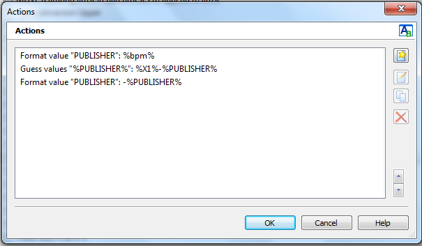

I am working with some files that are transitional, I make the bpm tag like 100-122 and then I have an action that copies -122 to the label (i.e. Publisher tag = label tag in Serato) tag to be able to use it in Serato.
I have to do this as a manual action like:
format value > "Publisher":%bpm%
Guess values > "%Publisher%":%X1%-%PUBLISHER%
format value > -%PUBLISHER%
That is a manual single action that does what I describe above. I'd like to be able to have a way to only execute that sequence shown ONLY if the bpm tag has a "-" char in it. Clearly I'm the one filling in the BPM tag to put the "-" char there but I have a super action that does major fixes of tags based on how I tag my files based on my preferences. I'd like to be able to add this to that super action but not sure how to incorporate it as a decision process.
No actually, I don't need X1. It was something someone when I first started using the program helped me out with or it was a help thread. So if there is a way not to use it, then that would be even better.
So your last entry would be the way to set it up and just replace X1 with %dummy% as mentioned? If so I'll give it a go....

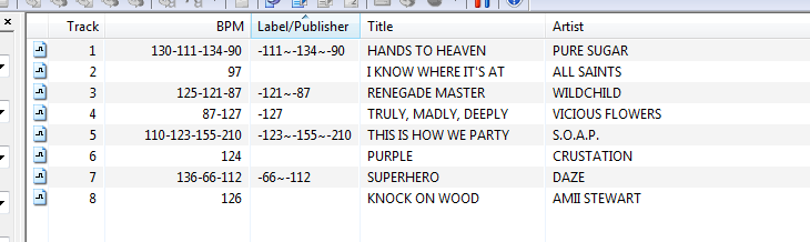

Upon closer inspection, I see that it is working, but its not happy with more than 1 ~ in the bpm. Many of my tracks have 3 to 6 transition levels. Hopefully a possible fix?
Serato follows the MP3 standard format which is numbers only. So I would want the first BPM value and then the first hyphen and everything following to copy to the label/publisher tab. Even though MP3TAG supports showing it, when the file is loaded in Serato, it only displays the number before the first hyphen it sees, so I put the BPM field and Label field side by side in serato so I can see the transistion data if it exists for that track.
So look at track 3 in the image, that is a standard one 87-127 so
BPM is 87 ---- Label is -127
Track 1 example 130-111-134-90:
BPM is 130 ---- Label is -111-134-90
So as shown, it is "almost" right and in the correct format, it was just adding the ~.
If it didn't add the ~ to the labels in my example image, it would match what I'm asking for above.
