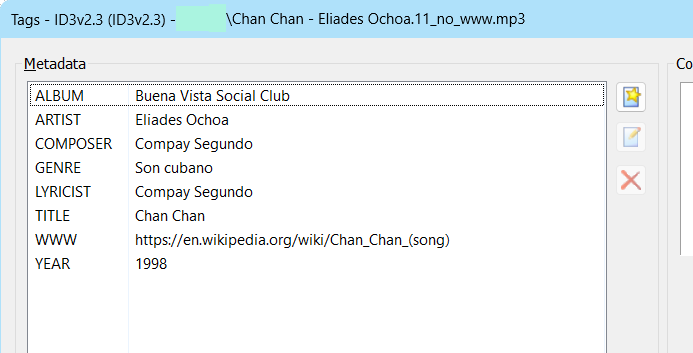

Silent data loss when saving recurring WWW/MP3 or certain/WMA tags
If a user enters multiple WWW tags in the Extended Tags dialog:
and then clicks OK, the dialog closes without indicating any error.
However, only the last WWW tag is saved.
All other entries are silently discarded, without giving the user any chance to notice that their data has been lost. After saving the tags become:
This occurs for both MP3 and WMA files.
It also occurs for any custom WMA tag, regardless of its name.
It also occurs for any built-in WMA tag (WMA attribute) that does not support multiple values.
