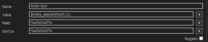

For the sorted artist it would be
Value: $meta_sep(artistsort,\\)
Field: %artistsort%
Here is my definition.
For the value, using the $meta formula gets all multi-value tags fields with that same name, using the defined separator.

Ok I have tested this configuration:
This was my first idea of what I should write down in the fields, in english adjectives usually goes before the name, so it is Sort Artist & not Artist Sort, but surprisingly you suggested me the opposite & it worked!
Just wondering how artistsort works but sortartist no.
I assume this means in the file there’s no field called sortartist but artistsort but what I do not understand is how you know it: how you discover that the correct field name is artistsort. Is there a list of the names?
