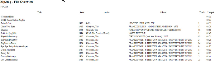

I used your modifications to the HTML output and yes it worked great and it does give you the total time. I might have been a little to happy about the outcome though. I found that doing about 2200 entries comes up with a different outcome. Granted it DOES give you the total time, even days, however it also gives you another column to the right of "Length" called "Filename" which shouldn't be there. so what I did was remove "[code]<td$if($odd(%_counter%), class="odd",)>%_filename_ext%" and everything was back to normal except the "Title" is a little to far from the left of the page but I can live with that. I'mgoingto add attachments to this, I hope, to show what I mean. I wanted to upload 2 files but it will allow me to only upload one. I chose the long file first, wanted to show the difference between the two. But yo try it and see what you get
It was my intention to show you where I added the extra piece of information so I appended the original html_standard script.

Just a followup on your last info in regards the font size.
Here's what I have as you explained it :
=Total Time: %_total_time%
I want to upload a copy of the result, something is off. Note that I have the font at "9" and note the text versus the outcome. I don't want to be a pain and I should be satisfied with the results but this is a little too much

and first $loop but it will not effect anything afterWell, I kept playing around, took me about an hour and a half but I got it. Here's what I did:
- Went under the original h1 and created an h2 with the same syntax.
- Put the h2 in front of the
and ended up with the following syntax:
=Total Time:%_total_time%
and it works. Attached is the result. At the same time you should be able to change the size of the text. I'm going to try changing the sixe of the text just to make sure but I believe that if it works at the top there should be no reason why it shouldn't work here.
