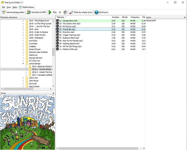

It is the program Free Lyrics Finder.

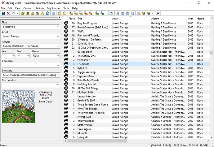

I have attached pictures so you can see what is happening. I add lyrics in Free Lyrics Finder.
Then mp3tag no longer displays the year.

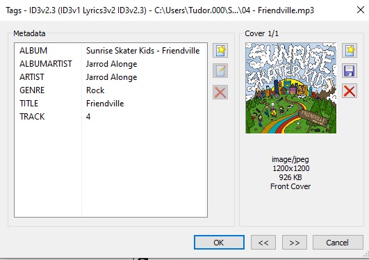

In "extended tags" it looks like it does not read the year correctly anymore? windows properties shows the year still so the value is still there. ???

"extended tags"
4
Also I will note that I only had this problem after updating to 3.03 from a build that was 3 years ago. (cant remember the version)
I see that you have Lyrics3v2 tags in your files. I think that these tags are from the ID3V1 family - but Lyrics3v2 tags are not supported by MP3tag.
Also, apparently you have written the data for YEAR not to the V2.3 tags - or the program that writes the lyrics to that strange tag is the culprit.
You could check whether the year is still there but only in the V1 tags if you switch off to read V2 tags.
You would have to get rid of the Lyrics3v2 tags, actually.
The correct field for lyrics is UNSYNCEDLYRICS.
6
Sorry the above is the correct "extended tags" after i have edited with Free Lyrics Finder.
How is it effecting the year? It makes no sense.
Especially because windows still shows the year....
Further investigation:
I set it to ONLY read ID3v1 and "year" displays correctly. When I set read to ID3v2, "year" shows blank. Even though I have ID3v2 write selected when i initially save the year. "Year" is the only category this happens with.
