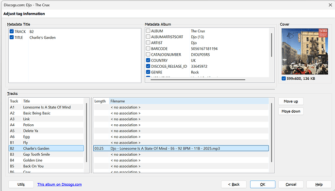

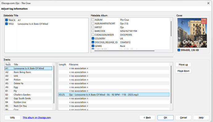

The metadata at the top is for the selected track in the bottom left corner. If you click on "A1 Lonesome..." under Tracks, you can see what information would be available for that source track on Discogs.
The lower right section is only for "linking" your left source track (and its metadata) to your existing local track and current Filename.

Especially in this case as I was only actually after the genre of the track and ended up getting the wrong title.
So perhaps the box to the right of the Tracks box should say - file changes applied too, that might make it more obvious?
or if there is only one track and you select B2 as an example in the tracks box, the length - filename box should change automatically for single tracks?

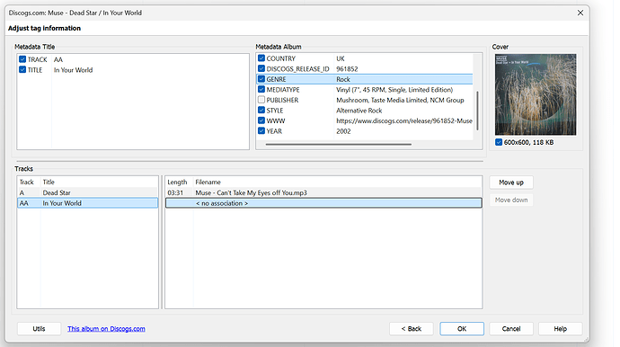

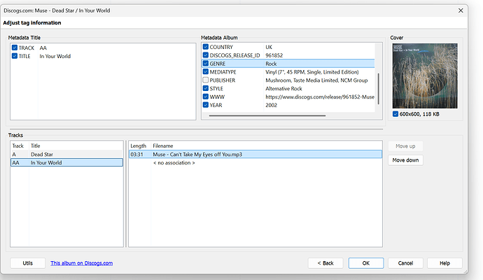

So at the moment if you select the track in the right lower box.
The left box is selected as linked
BUT if you select the right box it doesn’t highlight in the same way to show the relationship.

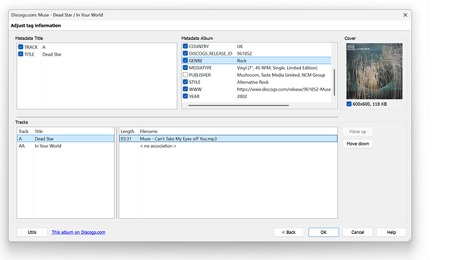

first attachment - select no association - AA selected left.
2nd
A is, but if I then select AA, it doesn’t move down. so if you are selecting the left box first the logic and connection is not obvious to the user.

The other issue is that the arrow in your first post doesn’t actually line up, it shows between tracks, so when you first release it, it slots into the track above.
The blue arrow should point AT the track it aligns with, not in between tracks.
Try this with one track from an album and you’ll see what I mean.
