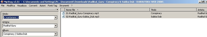

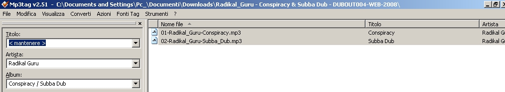

I accidentally messed up something with the mouse and now part of the edit bar disappeared
how do I add it again ?
I clicked in the view menu on "Main bar" but nothing happen
v 2.51
thanks
