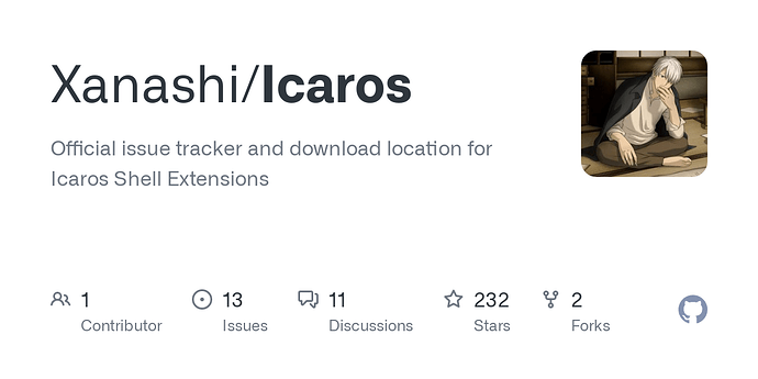

@anthony_smith75 : I suggest to report this issue here:
Ok I just disabled Icaros to see if the MKV files with Titles created by MP3Tag work in Windows Explorer as they should. Yes they do work when Icaros is disabled! So will log the issue with Icaros support then, as their good program may well be the issue here.
Done.

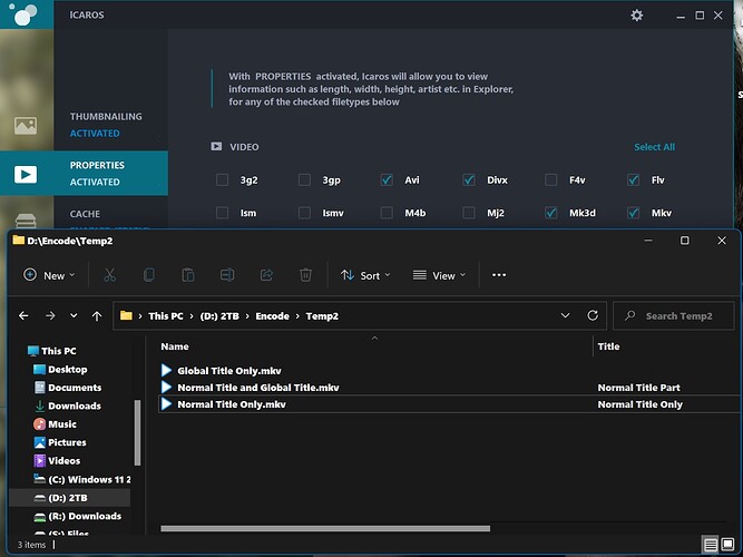

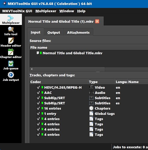

Ok have done some additional research and testing. Some programs like MKVToolNix and PropEdit will write a normal Title Tag. MP3Tag appears to only write Global MKV Tags. Very confusing. Windows Explorer without Icaros (Windows 11 22H2) will read both tag types but prefers global tags. Icaros will only read normal tags and ignores ALL global tags. We need some consistency here! Can we add normal MKV Title tag support to MP3Tag

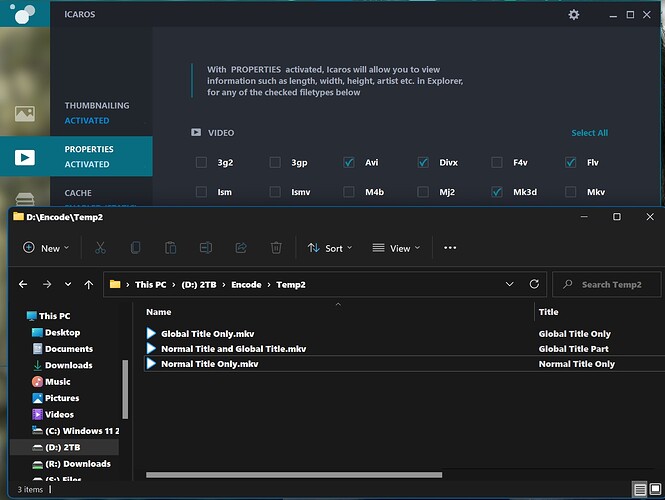

Just tested the Icaros 3.31 Beta1. Can confirm the Titles for MKV now work as they do in Windows 11 without Icaros installed. MKV Global tags have priority which is what MP3Tag writes. If there are no global tags then the normal tags are shown. If MKV has both normal and global then MP3Tag shows the newest and updates global tag when changed. Album, Album Artist, Genre, Year, Comments, Bitrate, Bitdepth, AudioTracks, VideoTracks and MANY MORE are working for MKV and FLAC files with Icaros 3.31 installed. Problem seems solved! Much thanks to all.
