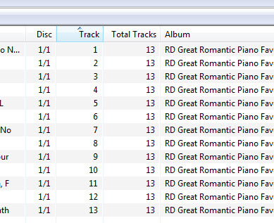

I'm new to the forum, and was just searching for the tag for Total Tracks.
I have quite a few Track tags formatted as #/#, and your script worked.
I see that TOTALTRACKS is stored as a user-defined TXXX field, as shown in this capture from MP3Diags.
I created a custom column for the %TOTALTRACKS% tag, and it displays just fine.
Thank you.
Edit: I should add that I renamed your script as "Add-Edit_Total-Tracks".
Edit: I use foobar2000 as my player, with Columns UI and NGPlaylist. I hadn't noticed previously, but if I add a Total Tracks column, formatted as [%TOTALTRACK%], then foobar reads the #/# in the %track% field and displays the total # in the new Total Tracks column. I used your script on only one album, but after adding the new column, all albums with #/# display properly.

hi there ! i'm new here. This was a long while so I doubt you might respond... but I'll try anyway. After looking and searching, I can't seem to make the the total tracks appear at all in the column. How you did you do that? For me, neither %_total% and %totaltracks% work for me...
What kind of files do you have?
For MP3s (ID3v2) there is no official TOTALTRACKS field. You can put the information the TRACK-field.
TRCK
The 'Track number/Position in set' frame is a numeric string containing the order number of the audio-file on its original recording. This may be extended with a "/" character and a numeric string containing the total numer of tracks/elements on the original recording. E.g. "4/9".
If you already have this information in a maybe user defined field have a look at the extended tag-view (ALT-t) to see what name this field has.
Thank you for replying!
I have mp3. In tracks, it does show track # / total tracks (3/13) but I wanted the total tracks in that album to show in a different column. It's unfortunate that it doesn't allow that.
Does it also apply to m4a files?
Please note that the ID3 standard is as @poster showed you. So the format for the track number and the totals is x/y.
If you want to have a different display, then you can set up your own column definition that shows the number of total tracks separately - but beware that you cannot edit in this field as you would have to merge this data with the track number to get the format right again.
So if the "it" in
refers to MP3tag then this is not correct as you could get define a column for the total track number.
No. There is no trackformat like 7/10 with m4a-files.
Ah I think I understand ! I'll try to work on that. Thank you so much for your help !!
edit: I just figured how to do it ! It was easier than I thought ! I went back to @stevehero's reply; The first time I read it, it was so confusing. Anyway, thank you for your time. Sorry for the bother.
