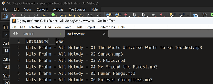

I just created an export file on my Fritzbox with the sample script - and the tab character appears like expected:
grafik
This is what the export script looks like:
grafik
The export path was like this:
grafik
I've moved this to Support now, it's unclear if this issue is still present for the OP.
I've just tried to reproduce this too, and it correctly writes a TAB 0x09
