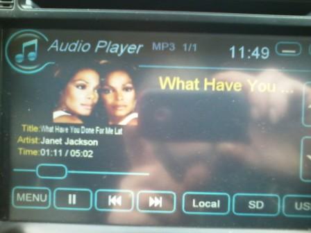

With a blank flash drive I put the one mp3 file on it with nothing else and the player shows this album art and track name so i was thinking that it is reading a tag, it's just a tag that mp3tag does not support?

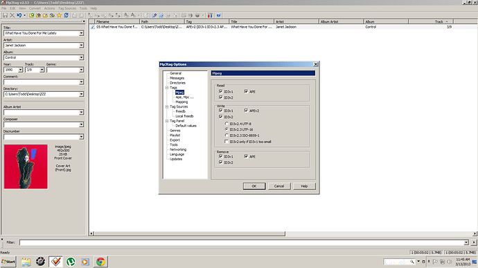

Thought this might help me explain better. This screen shot shows the tagged file (note the album art, it is tagged as "front cover" and it is the only one.
This is the same file playing in the player. (note the art is different) If I could figure out how the unit is reading that art work then I should be able to tag the rest of my files to show some art.
Thank you for the screendumps.
If I see your MP3tag settings correctly then you write APE tags.
Don't.
Just as an experiment: in
File>Options>Mpeg
Untick "Read" and "Write" for APE
then reread the track. Does the displayed information differ from the expected?
If right now the other fields are empty (because the info is stored in the APE tags) re-enable "Read" for APE.
Then re-read the file, use the context menu of the files list to cut the tags fromt the file and then immediately afterwards paste the tags again.
What does your player say now?
File>Options>Mpeg
No still the same.
That's good. Because that means that you do no loose any information if you do not write the APE tags any more.
MP3tag reads tag versions as follows: APE>V2.3>V1
So the contents of the APE ones overrules all the others.
