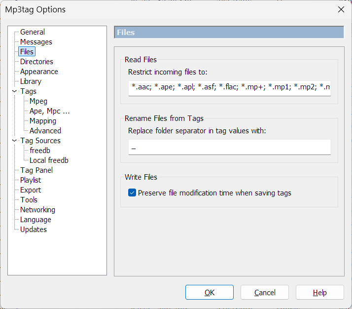

** Update 19.6.2026 for future readers:
Starting with Mp3tag v3.35 the
"Preserve file modification time when saving tags" option
and the
"Restrict incoming files to" option
can now both be found in the new
File -> Options -> Files part:

Unfortunately it completely misses the point. MP3Tag has a setting which enables timestamps to be preserved.
I want to identify material changes to files by timestamp, but if timestamps are set to be updated in MP3Tag it also updates the timestamps on files which get touched incidentally with no material change to the content.
