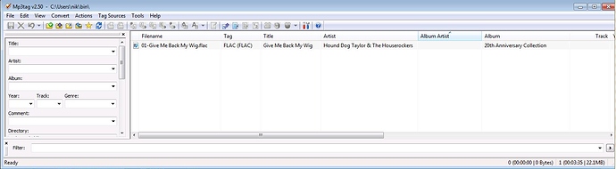

I've also attached a screenshot of the MP3tag display for the same file
'Album Artist' should also be viewable in the Tag Panel on the left. Is it empty there as well?
I'd start by checking the definition for that column in the settings. Right-click the column headers, then 'Customize columns...', find 'Album Artist' and click on it.
Value: ?
Field: ?
Sort by: ?
For what it's worth, mine looks like the following, but I've been running Mp3tag for years, so probably defined it myself rather than it being the default definition:
Value: $meta_sep(albumartist,\\)
Field: %albumartist%
Sort by:
I put your column definition in and the Album Artist showed up in the column, but it doesn't show in the Tag panel. Interestingly it was different from the entry on the source machine for that column (though I've never changed the configuration for columns on either system). However, the missing year and track number info have the same column definitions on both systems, but those fields don't show on the destination system.
