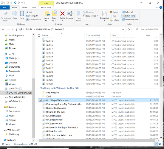

WMP tags when burning an audio CD
When I create an audio CD with Windows Media Player, it creates 2 sets of files on the disk – 1 is all 1K shortcuts, and the other set is all the actual MPEG files with all the correct song data (see screenshot). For some reason, the shortcuts do not have any of the song data – only track1, track2 etc… and both Winamp and VLC use this data to display, and so all you see in Winamp or VLC is just track1, track2 etc… What I can’t figure out is where or what tags Windows Media Player is looking at when it writes these shortcuts, so I can use MP3TAG to populate those fields with the song data. I don’t understand why WMP is creating these 2 sets of files to begin with, and why the shortcuts do not provide the song data, but that’s what it does… if you can shed some light on that, that would be helpful. Also, are there any plans for MP3TAG to have a disk burning utility in the future?
Thanks

Okay, lets clarify everything here.
I am using your run-of-the-mill Sony CD-R disks
I am using WMP 12 to create an “Audio CD” – I have selected to burn an “Audio CD”
I just drag and drop the files I want on the CD into the burn list
I press the “Start Burn” button, and all the songs in the burn list are written to the disk, and the disk is ejected and ready to play.
As you can see from my original screenshot, WMP is writing a shortcut for every track, which are all 1K in size, and all are “CD Audio Track Shortcut” file type. Then it also burns the actual file as an “MPEG Layer 3 Audio File” (which I can only assume is the long name for MP3), so what I mean when I say “Actual file”, I am referring to the MP3 file of the song, and all the song data is present in the MP3 files. Looking closely at the screenshot, you can see all this. And it was mentioned that the format is changed to “the audio cd format (PCM, I think)”, but it appears that the actual songs (NOT the shortcuts) are in the MP3 format.
So no matter what I play this CD with or in, only the shortcut is being referenced for tag data, which is an assumption on my part based on the fact that using either Winamp or VLC player to play the disk, it only shows Track1, Track2, Track3, etc…, and no other tag data. Again, it plays the song no problem. On my boom-box, it only shows the track # in any event, so it makes no difference there, and again, the CD plays just fine. And why it says “Files Ready to Be Written to the Disc (51)” above the MP3 files is a mystery to me, as all the files are already written, which is proven when you look at the CD properties and see how much space is used and left, or just by successfully playing the disk in a portable player.
Also interestingly, when the disk is in the computer and I am browsing the files, I can click on any one shortcut and Winamp (and/or VLC) will play the song, only showing “Track1” for example, and no other data. But when I click on the MP3 file, it will play the song AND show all the tag data.
So to restate my original issue, when allowing the computer to just start playing (Autoplay) an audio disk when it is inserted (or when I right click on the disk, and select “Play with X”) I wanted to know why these players won’t /don’t access the tag data from the MP3 files, and how I might fix that? I know it was said that none of the tag data copies over when burning a native audio CD, but that is only true with the shortcut files – the MP3 files DO have all the tag data intact… so it’s just an issue of the player not looking there for it, right?? It has to access the MP3 file to play the song, so why not read the tag data from there too???

These shortcuts you see have not really been created by WMP. Actually there are no files on an audio CD, it has its own structure of individual tracks. These shortcuts you see are just the way how Windows presents you the audio CD, allowing to playback the individual tracks directly.
Wow... great help everyone! Let me respond to some of these comments...
Son of a gun, learning something new everyday! Sure enough, in my other laptop, all those MP3 files i thought were burned on the disk, are not there!
With the direction this conversation has gone, I don't disagree... but in my original quest to deal with my "problem", i thought there might have been a way to use Mp3tag to edit in the missing tags onto the shortcut files... which I have now learned are not actually files, but just some other kind of pointer to the location of individual tracks written to the disk as vilsen & PHW explained... what a revelation!
