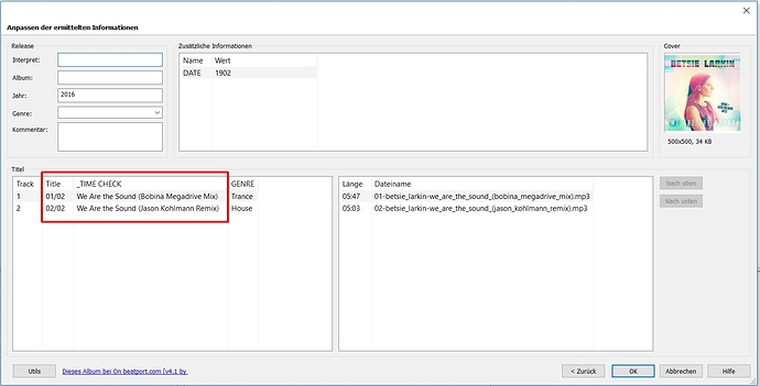

Hello,
i think there is something wrong with the script (Artist + Release)
I have select only a few Datafields but i get this Respond:

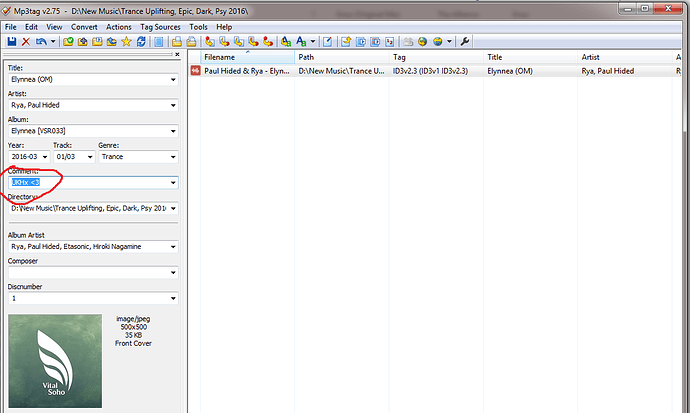

Hi everybody,
fist of all I apologize for my english because it isn't as good as it should be.
Thank you stevehero for your amazing job, your script helped me to save a lot of time!
I have a little problem with the latest version, I'm not able to get the musical key anymore. Can anybody help me to get it back please?
