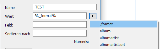

I just came across a %_format% item in the file list customization dialog, which I don't remember having seen before. It doesn't seem to be in the documentation, and assigning it to a column gives an empty string.
Is that a spillover from the new _FORMAT option in the tag panel, or am I missing something?
(using v3.37-beta.2)
Yes, thanks for pointing! New field names are automatically collected from the Tag Panel and I forgot to filter for this one. I'll correct this with the next release.
