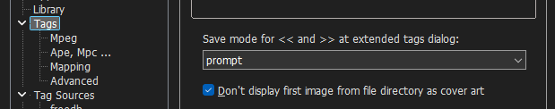

If this is related to this problem:
then the answers are still the same: covers have to be embedded or, if the files are all external files, untick the option
Don't display first image from the directory as cover art
