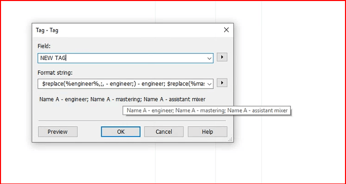

Format string: $replace(%engineer%,;, - engineer;) - engineer; $replace(%mastering%,;, - mastering;) - mastering; $replace(%assistant mixer%,;, - assistant mixer;) - assistant mixer
I tried but it doesn't work properly. It seems that you don't consider multi-valued tags

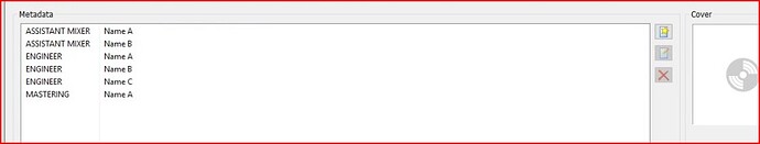

These are the tags of my test file
this is the conversion screen

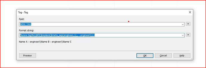

I tried using the second solution you wrote
%new tag%\\$if2(%engineer%,$replace($meta_sep(engineer,; ),;, - engineer\\),)
but it returned the error "Invalid IF2 syntax", so I changed it by removing %engineer% after the round bracket $if2
%new tag%\\$if2($replace($meta_sep(engineer,;),;, - engineer\\),)

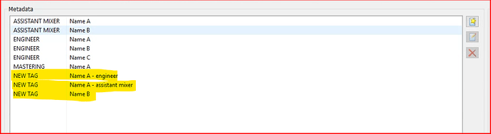

this works better except for the last value of the tag where it doesn't add - engineer

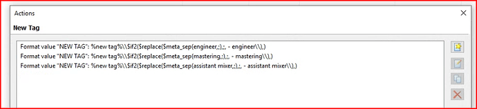

I also tried to create the action group for these 3 fields, but something strange happens. As if the various actions overwrite the tags

if you want to use several tags of the type NEW TAG then you would have to join the field to become a single field with $meta_sep(new tag,\\) before you can add further data. Otherwise only the first instance of the field is taken.
