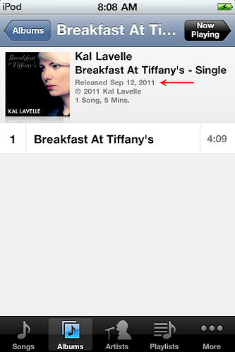

but when i purchase music of the iTunes store it comes included with release date and it does actually show up in iPod under the album name!

hey!! i fixed the problem for anyone would need to know, if u have a song you want to tag it with the release date and the copyright information and want that info to show in iPod here's how:
-first tag the song with this tag (ITUNESPURCHASEDATE) using View>Extended Tags
and add any value you want as the purchase date e.g. (2011-09-14 05:58:30)
this will make the file behaves as a purchased file.
-then write the release date in the YEAR tag with this format YYYY-MM-DDThh:mm:ssZ
and if you want to add the copyright info too you can by adding the tag (COPYRIGHT) and write in the value you want.
i came to this after alot of tries and effort hope you'll find it helpful..!!
thank you all for your collaboration it's appreciated..

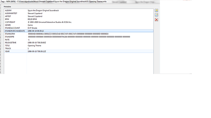

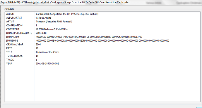

tried with spyro the dragon video game soundtrack on itunes i did everything right but it still says released 1998 i put this in year 1998-09-10 T09:30:12Z and this in ITUNESPURCHASEDATE 1998-09-10 09:30:12 does it not always work because it worked one one album not on this one i will be uploading photos of my progress the spyro one is messed up and the cardcaptors one is fine
Remove the space in the YEAR field:
1998-09-10T09:30:12Z
and RELEASETIME is only for mp3
