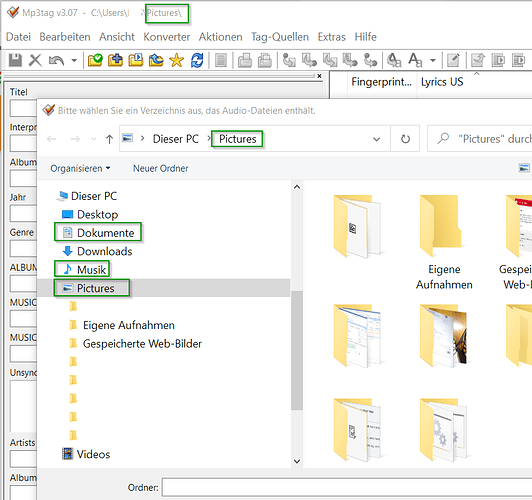

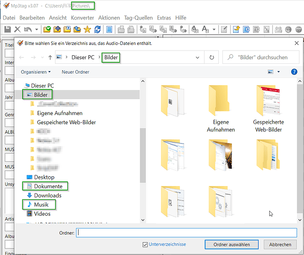

Are you sure?
I can see the non localized "Pictures" folder name in the title bar of Mp3tag.
I can see the non localized "Pictures" folder name in the variable %_folderpath%
BUT:
If I try to open a folder inside Mp3tag, I see the localized "Bilder" folder name on several places.
Where exactly do you see Mp3tag ignoring localized folder names elsewhere?
