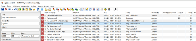

    Here is an extract of my directory. Album is set to XX

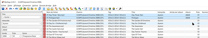

    And here if the result of the Action execution. Album is set to ABAB instead of just AB
