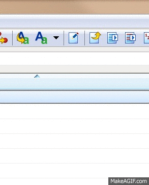

REQUEST: move list of actions right next to its icon
I would like to propose for the list of actions to be moved further to the right, so that the icon would stay always visible. This visibility of the icon is not the goal itself; it is to done so that there would be no longer issues with accidentally executing some action, as it was described here /t/16883/1
This animated GIF illustrates what is happening and how it should / could look like
Until now I managed to avoid involuntary executing of actions by putting on top of my list of actions some actions groups instead of ordinary [single] actions; because groups after clicking them just show more actions on the right side, and do not execute any user defined tag changes
But having a Winamp docked at the top in the form of a thin bar, that sometimes needs to be expanded and thus taking more space, moves the action icon further down the screen. And so the icon it moved relatively to actions from the list. So I have to take into account how my list will look like in three different states: without Winamp, with Winamp thin, with Winamp thick. So every removal of action group from my list may simply result in coming back of the problem of accidental execution of action
It is such a drag, that can be ended with a small adjustment
