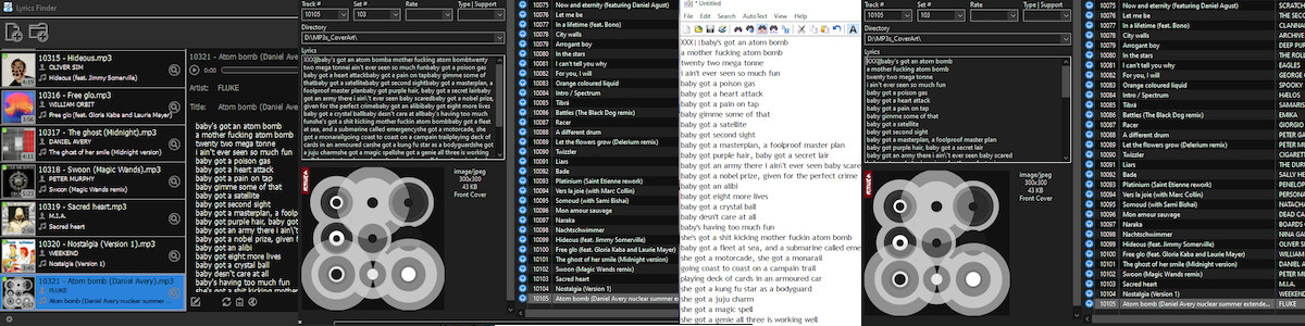

Hi Florian (and Community),
I noticed a recent change in the handling of UNSYNCEDLYRICS when pasting lyrics from Lyrics Finder.
Previously, Lyrics Finder → Mp3tag preserved the line breaks correctly. Now the lyrics appear as a single block of text in Mp3tag.
However, the line breaks are actually present in the text:
  1. Lyrics Finder → Mp3tag: lyrics appear as one single block.
  2. Mp3tag → Notepad: the line breaks are displayed correctly.
  3. Notepad → Mp3tag: the line breaks are again displayed correctly.
So the workaround is simply copy → paste to Notepad → copy → paste back to Mp3tag.
The field is UNSYNCEDLYRICS.
I am currently using Mp3tag v3.36 beta.6 (I also tested beta.2, with the same result). The same Lyrics Finder workflow worked correctly in earlier versions.

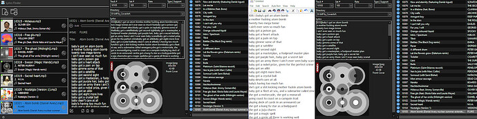

I am attaching a screenshot showing the four steps side by side:
Lyrics Finder → Mp3tag → Notepad → Mp3tag
This seems to indicate that the line-break characters are present in the clipboard content, but are not being interpreted/displayed correctly when the text is pasted directly from Lyrics Finder into Mp3tag.
Any help? Thanks!

You're looking at the synchronized lyrics SYLT frame here, which uses 0x00 as sync identifier. So I don't see anything wrong here.
Does this tool also write unsynchronized lyrics to a USLT frame? If so, how are linebreaks encoded there?
UPS, my bad.
Yes, it writes USLT but inserts only a 0A (LF).
grafik
