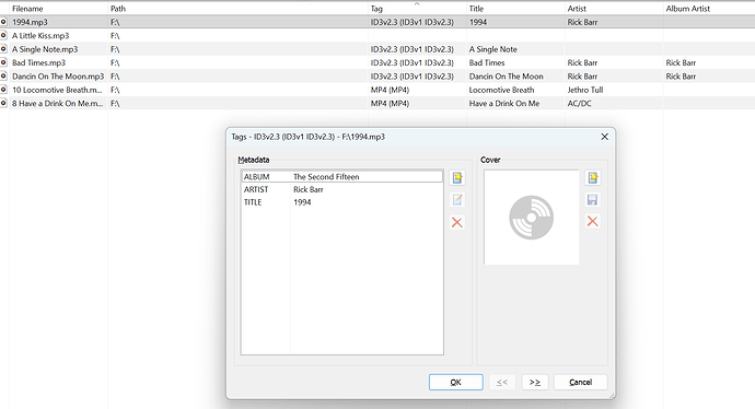

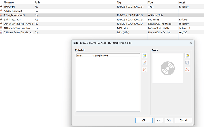

You can compare a track with the TITLE filled by Convert Tag -> Tag and %_filename% with another track where you filled the TITLE content manually.
Press Alt+T on the two tracks and compare the content.
If you like, you can show us a screenshot of both metadata overviews.
BTW: Have you entered exactly the same content manually?
Or was it much shorter, or did it not contain any special characters?

Thanks for the quick reply. I’ve attached two screenshots, one of a track where I entered the TITLE manually, the other using TAG - TAG (“A Single Note” is the manual one, which works fine). There are no special characters, these are all just plain alphanumeric.
Yes, this is in my Toyota RAV4. Again, it’s showing metadata correctly for everything else, just not the TITLE track where I’ve used TAG - TAG to copy the filename.

Visually, I can't see any obvious reasons.
Could it be that your TITLE content 1994 includes any trailing invisible characters like a space?
Please double click on the value 1994 in Alt+T and check whether there are any character before or after the four numbers.
