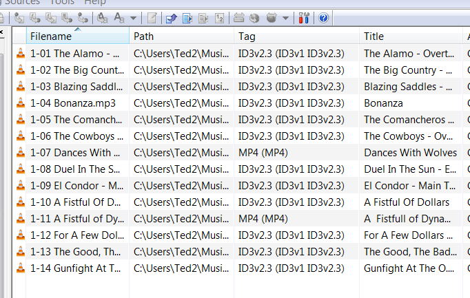

As suggested by garym, I have checked and the two files I want to edit are MP4 tags while all the others are ID3v2.3 (!). Never noticed that before and don't have a clue what they mean. Have attached screen shots.

You were correct, they were M4a. I have converted them to mp3 and replaced them in the target folder. When I did, Mp3tag immediately saw them with my correction! I also noticed that after my conversion to mp3, the tag type changed to IP3v2.4 on cuts 7 and 11(screen shop attached). Again, not sure what that means.
Oh, and I don't see any red X on the upper menu bar (screen shot attached). Thank you so much for your suggestions and comments.

The "X" is the second icon from the left in your third picture (just to the right of the disk icon (save)). It may not be red unless files are selected and highlighted.
p.s. it appears that many of your files have both ID3v1 and ID3v2. Won't hurt, but sometimes this can cause issues (edit one of them but not both and then get differences in tags). Modern players rarely ever need to see ID3v1 tags. In my own case, I deleted all the Id3v1 tags. Load up all the files, select all. click SAVE, then select all and click the X. This will follow the rules setup in your mp3 tag settings (read ID3v2.3, write Id3v2.3, remove all but Id3v2.3)
