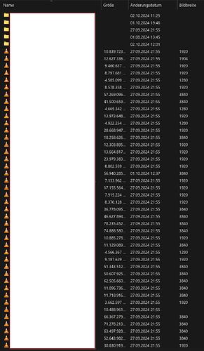

That would be easy to check: Just add the two columns "Bildbreite" and "Bildhöhe" in Windows Explorer and check if the properties are natively shown:
I'm not sure if the properties are called "frame height" and "frame width" or just "height" and "width" in a English Windows Explorer.

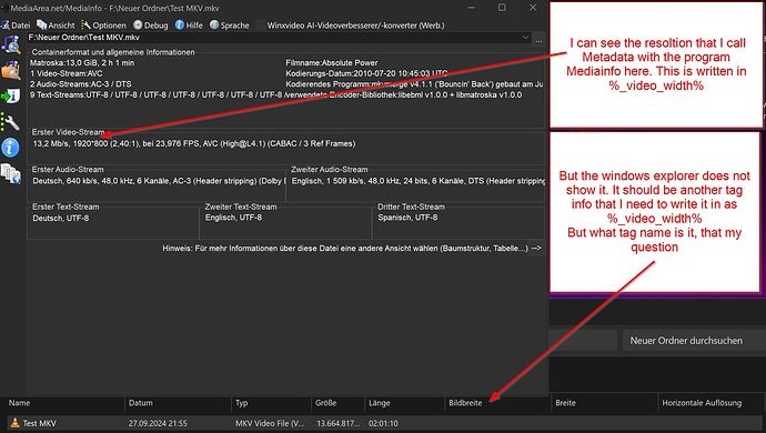

Thats exactly what I want. Just "Bildbreite" would be enough for me.
I know the command of the I call it Metadata, in that 1920 is in.
It is %_video_width%
I can already write it in the dataname, so this should be correct source command for this data.
But I do not know the tag name for the "Bildbreite" as you show in your picture.
I tried %_frame_width% and %width" already, but it do not write 1920 in the correct tag, that windows need for its explorer view.
How did you get it like you show it on your picture?
Do you know the tag name in Mp3tag?
How should it be like ? %_video_width%% ????? %

The resolution part "Bildbreite" (1920) will be displayed without altering the MKV at all.

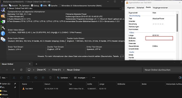

If you look at the "Detail" on the right side of your Windows Explorer, do you currently see the values as shown (yellow highlighted) in my screenshot above?

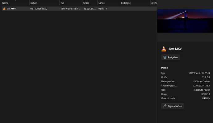

No I do not see it in the windows details. Thats the point why the explorer cannot show it, too. I think.
then I recommend this 3rd party tool:
And maybe have a look at this thread:
Using the above "Icaros", VLC - for example - shows the technical details from a MKV as:
I installed Icaros and it works now.
