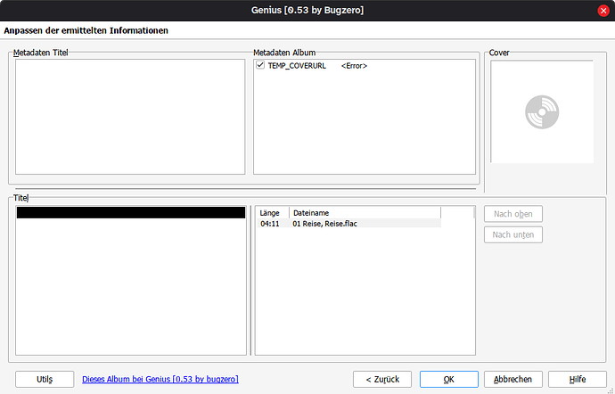

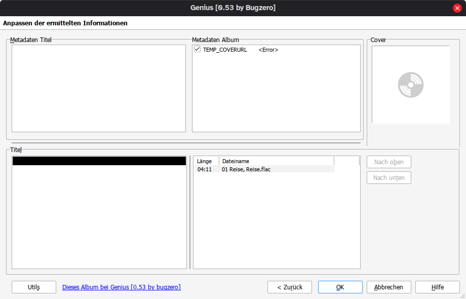

Hello @bugzero, since yesterday the plugin doesn't work anymore.
I tried multiple titles and tried it on Windows 10, but it's always the same.
genius.com is accessible through the web browser (firefox 153.2.0esr). The links generated by the plugin (https://genius.com/Rammstein-reise-reise-lyrics in this case) are also accessible.
Could you please look into it? Thank you!
Edit: Nevermind, I was able to fix it with an LLM. The issue was that Genius swapped the attribute order in their <meta> tags. The script's regex expects content="..." to come before property="og:...". Genius reversed the order (property first, content second) at some point. And since that first regex never matches, <cover:start> never gets inserted, findinline fails, and I get <Error>.
Just added these lines under the Search optional tags comment inside Genius#Lyrics.inc:
regexpreplace "<meta\s*property=\"og:image\"\s+content=\"([^\"]+?)\"\s*\/>" "<cover:start>$1<cover:end>"
regexpreplace "<meta\s*property=\"og:title\"\s+content=\"([^\"]+?)\"\s*\/>" "<title:start>$1<title:end>"
regexpreplace "<meta\s*property=\"og:url\"\s+content=\"([^\"]+?)\"\s*\/>" "<url:start>$1<url:end>"
