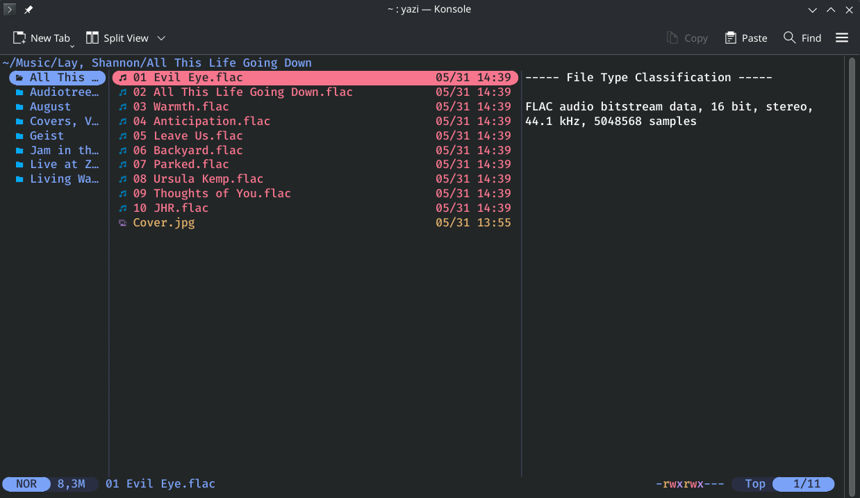

For example I've integrated it into yazi yesterday.
yazi mp3tag
In case there are other yazi users in here (unlikely, which is why I didn't include it in the guide):
in yazi.toml you can add mp3tag as an [opener]:
tag = [
	{ run = "/mnt/mp3tag/mp3tag-context-menu.sh %s", desc = "Tag",      for = "unix", orphan = true },
and then assign it to folders and audio files in the [open] section:
rules = [
	# Folder
	{ url = "*/", use = [ "edit", "open", "reveal", "tag", "convert" ] },
	# Media
	{ mime = "{audio,video}/*", use = [ "play", "reveal", "tag" ] },
