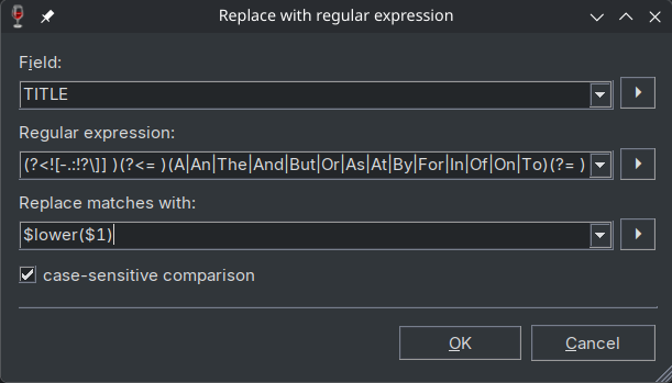

The first pitfall is having to further escape [] within the already fairly cryptic regular expression, turning:
(?<![-.:!?\]] )(?<= )(A|An|The|And|But|Or|As|At|By|For|In|Of|On|To)(?= )
into:
(?<!'['-.:!?\']'']' )(?<= )(A|An|The|And|But|Or|As|At|By|For|In|Of|On|To)(?= )
However even with this working regex, the $lower() function does not appear to be working in this context (or I also have to escape this and don't know how).

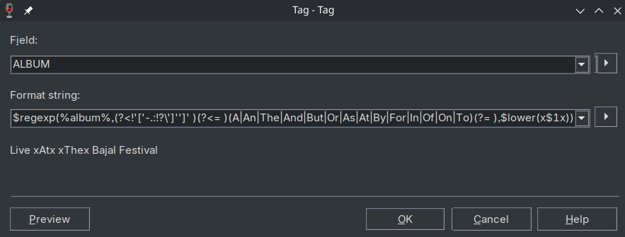

I tested the regexp function in a Tag - Tag Converter:
$regexp(%album%,(?<!'['-.:!?\']'']' )(?<= )(A|An|The|And|But|Or|As|At|By|For|In|Of|On|To)(?= ),$lower($1))
Live at the Bajal Festival would be the expected result.
The regex matches successfully, however $lower() is not applied to the matches.
Surrounding the matches with x shows the successful match and replacement:

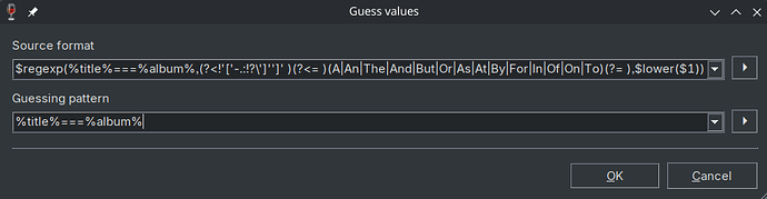

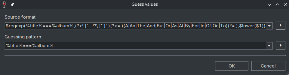

Using the same approach in a Guess Value action (following ohrenkino's approach) also did not yield the expected result.
Adding ,0 to the $regexp to disable the ignore case setting also had no effect.

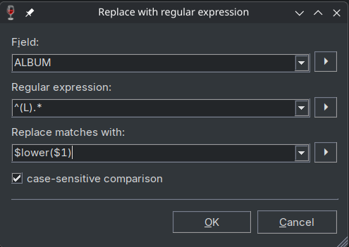

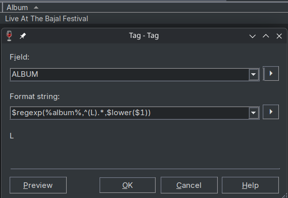

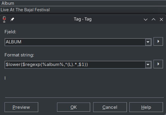

Simple reproduction:
Intuitively these 2 should be identical, but $regexp() yields L while the action yields l.
Adjusted and now working workaround for the core issue
Anyhow, after adjusting the Guess Value workaround to use \l instead of $lower() (and adding dinosaur emojis instead of = because I doubt they'd ever be part of a tag), this now works:
Action type:
Guess Value
Source format:
$regexp(%title%🦕🦖🌋%album%,(?<!'['-.:!?\']'']' )(?<= )(A|An|The|And|But|Or|As|At|By|For|In|Of|On|To)(?= ),\l$1)
Guessing pattern:
%title%🦕🦖🌋%album%

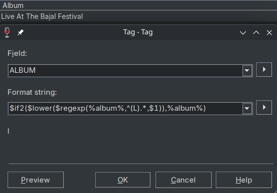

It's a pity that $regexp() always returns something ($0 or in this case %album% when no match is found and the replacement when a match is found).
With my wordy and error prone workaround from this thread, $lower() (and other string functions that do not have a regex internal replacement like \l) can be used without risking unwanted changes.

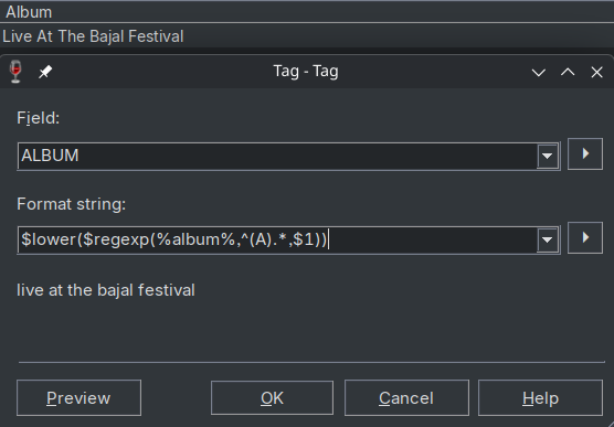

$if($neql($regexp(%album%,^(L).*,$1),%album%),$lower($regexp(%album%,^(L).*,$1)),%album%)
The check if the replacement is identical to the source field is needed because otherwise, $lower() would be applied to the source field in the case of no match as seen here:
Match:
No Match:
